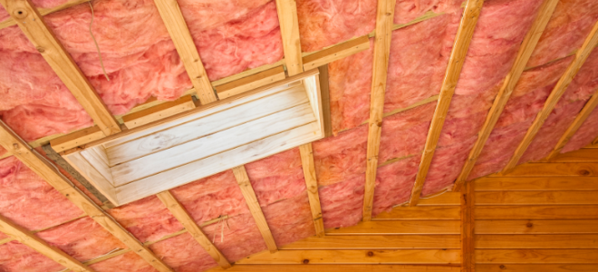

Although insulation can be made from a variety of materials, it usually comes in four types: batts, rolls, loose-fill, and rigid foam boards. Each type is made to fit in a different part of your house. Batts are made to fit between the studs in your walls or between the joists of your ceilings or floors. Batts are usually made of fiberglass or rock wool. Fiberglass is manufactured from sand and recycled glass, and rock wool is made from basaltic rock and recycled material from steel mill wastes. Rolls or blankets are also usually made of fiberglass and can be laid over the floor in the attic. Loose-fill insulation, usually made of fiberglass, rock wool or cellulose, is blown into the attic or walls. Cellulose is made from recycled materials treated with fire retardant chemicals.

Ventilation plays a large role in providing moisture control and reducing summer cooling bills. Install attic vents to help make sure that there is one inch of ventilation space between the insulation and roof shingles. Attic vents can be installed along the entire ceiling cavity to help ensure proper airflow from the soffit to the attic, helping to make a home more comfortable and energy efficient.
Do not block vents with insulation, and keep insulation at least 3 inches away from recessed lighting fixtures or other heat producing equipment unless it is marked "I.C." – designed for direct insulation contact.

The easiest and most cost effective way to insulate your home is to add insulation in the attic. To find out if you have enough attic insulation, measure the thickness of insulation. If there is less than R-19 (6 inches of fiberglass or rock wool or 5 inches of cellulose) you could probably benefit by adding more. Most U.S. homes should have between R-19 and R-49 insulation in the attic.
