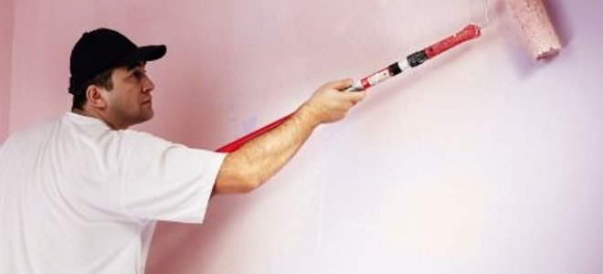

When painting ceilings, use a high-quality roller with an extension, so you can easily reach all areas of the ceiling without strain. This way ladders will not be needed except for touch-ups and cutting in. These same extensions are used for the high areas of the walls.

To avoid splattering, distribute the paint slowly on the ceiling and walls. In the beginning, use overlapping "W" shaped strokes. Begin at a corner and work across the wall or ceiling. Cover about three square feet at a time. After you have made your W-shaped zigzag patterns, fill in the unpainted areas with parallel strokes without lifting the roller from the surface. Increase the pressure on the roller as you work to deliver the paint smoothly.
When rolling into unpainted areas, feather the paint in, in a series of light strokes, and lift the roller at the end of each stroke. When you need to reload the roller, begin the next section, rolling in a zigzag into the outer border of the area you just completed. Then lightly roll the area between the two sections. Paint the entire surface. Do not stop and allow the paint to dry on part of the wall or ceiling. If you do, the different areas will be apparent when you’re done.
Some professional painters don’t like the “W” method, because if you’re not fast enough the overlaps may show up as the paint dries. These painters use a continuous line across the ceiling or from floor to ceiling on the walls. For this, use the extension pole even when you’re doing the walls. That saves you from stooping to get the bottom or reaching to paint the top. Roll in a straight line from floor to ceiling, overlapping each stroke by ½ a roller length for good coverage. If the roller edges start to form lines of built up paint, just roll the edges of the roller hard to take out the excess paint that builds up on the ends.
Either way, be systematic. Start at one end and work your way to the other without stopping. No random patterns, filling in the wall here and there, and no taking brakes in the middle of the wall.  It’s repetitive work, but once you get into the groove it should go quickly.
