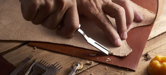

hands cutting leather with a special curved tool

Cutting Leather
This is a delicate process, as you don’t want to damage leather in the cutting process. One of the best tools you can have is a cutting mat with a graph or connecting dots on it to help you cut in a straight line.
There are many different tools that can be used to cut leather. The thicker the piece you’re working with, the sharper and deeper the cut will need to be. Regardless of how thick the leather piece is that you’re working with, never use a dull blade, as it can cause wrinkles and rips.
Many people assume that scissors or shears are the best tool for cutting leather. However, this is rarely true. Unless you’re simply trimming parts from a hide or making something round, these are not the cutting tool of choice.
Probably the most commonly used tool to cut leather effectively is a basic utility knife. These are easily accessible, easy to keep a sharp blade on, and reasonably priced.
While it may be tempting to use an Exacto or craft knife for cutting leather, they’re not ideal as they’re not designed for the kind of pressure needed to puncture leather. Using them could lead to a ragged edge, which is usually less than desirable.
Another customary tool that works well is a rotary cutter. These allow for an easy cut and a sharp, clean edge. The downside to this tool is that it’s more expensive than a utility knife.
