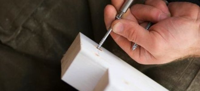

Step 10 - Screws and Pilot Holes
The threshold should be fixed to the floor by brass screws. Even distribution, say, one every 6 inches is pleasing to the eye. Drill pilot holes for each screw to make the job easier, and to prevent splitting either the threshold or a floor board.
Step 11 - Counter-Sink
Counter-sink each pilot hole in the top of it using the counter-sink bit and drill. The bit will widen the top of the pilot hole and create a shoulder that is at the same angle from horizontal as the base of the head of the screws. When driven home, the screw head will be just below the level of the surface.
Step 12 - Secure
Ensure each screw is driven through the threshold and into the floor without creating a gap between the two. If this proves impossible, make the pilot hole just big enough to accept the screw.
