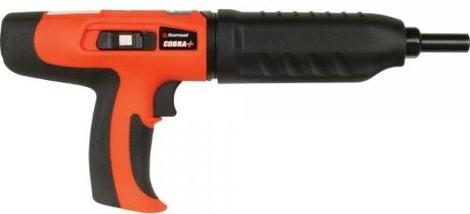

a powder actuated gun shaped tool

High Velocity
There are few differences between low and high velocity powder actuated tools. The main factor distinguishing one from the other is the total velocity at which they operate. High velocity tools produce much more velocity than the low velocity versions and must be handled with certain restrictions because of this.
For the high velocity variety, there is no piston in the chamber so the chemically induced propellant is directly charged against the fastener. This type of Ramset gun can charge the fastener well over 492 feet per second.
That is the line dividing high and low velocity powder actuated tools. High velocity tools are not currently manufactured or sold in the United States but some still exist (and are still in use). The operation of a high velocity actuated tool is almost identical to that of a handgun.
Low Velocity
Low velocity powder actuated tools produce a velocity less than 492 feet per second. The difference in the mechanics of the tool is that low velocity tools use a piston in the chamber. This piston absorbs the charge from the chemical propellant and fires into the fastener lowering the total overall velocity in which it fires.
Safety and Regulations
Most powder actuated tools (both low and high velocity) usually include a muzzle safety interlock. If the muzzle of the tool is not pressed firmly against a surface then it will block the firing pin and not allow it to go off. This prevents the tool from firing by mistake or if it is dropped. Most jobs that require the use of a Ramset gun require proper training and certification before someone is allowed to use the tool on a job. Other countries have additional regulations and laws in effect to make sure the guns are safely operated at all times.
