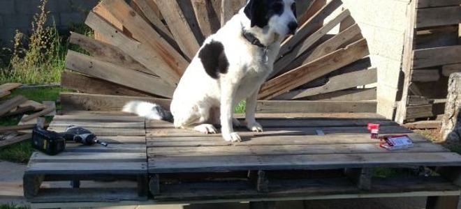

Step 5 – Create the Backrest
Now you’re going to use the slats. You need something round to create your pattern. I used an upended 5-gallon bucket. Set the slats around the bucket like rays extending from the sun. Start with slats extending from the center line of the circle, opposite each other, and continue the arc on both sides ‘til they meet at the top.
Make an Indoor/Outdoor Upcycled Pallet Daybed, Justin DiPego
Measure the distance between the ends of the bottom slats and cut a 1x4 to that length. Remove the bucket and set the 1x4 along the bottom of the array. Now cut 2 1x4s to go from the top of the array to the bottom of the cross piece, and 2 to go from the edges of the arc to the bottom of the cross piece. Tack them all together, securing the slats in the arc. Set the crosspiece of the backrest along the back edge of the bed and screw it in place.
Finally, cut a string to the length of the bed. Secure the string to the center of the cross piece and holding it taut use it as a guide to mark a pencil line in an arc across the array. Cut the array down to side along this line to make it fit the bed.
