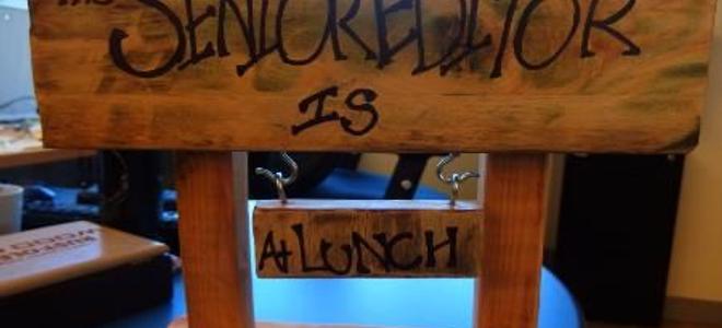

Out of necessity, this was the first sign. I had an 8-foot board, 5 inches wide, 1 inch thick and painted green. It was out in the elements for years, so the paint was both baked on and peeling off. Perfect. I knew I wanted a one-foot base, so I cut the green board at 14 inches, to overlap by an inch on each end. Then I sanded it smooth. The base and posts would be 2x2s. To make things easy for myself, I decided to make everything 12 inches. I cut 3 for the base and 2 for the posts. Then cut 2 1 ½-inch sections out of one (the actual width of a 2x2), so the posts could slide into the base. Then it was just a matter of sandwiching the base pieces together with the posts and screwing them all together.
Senior editor sign
I screwed hooks into the bottom of the sign board and cut a smaller piece to fit between the posts. Then I did the lettering with a fat, black Sharpie.
