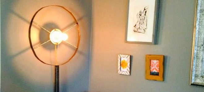

A wall that projects only about five feet into the room created a dark corner in a friend’s living room. But the couch is butted up to that corner, so any lighting solution needed to fit in a tight space. Faced with a problem solving opportunity, I designed and built a floor lamp with a flat profile that would illuminate the corner. My material of choice: steel.

I wired it to a simple lamp holder with a pull-chain switch and secured it to the plate in the center of the hoop. I fed the chain down the hole where the cord goes, so it’s all tidy.
Make This Industrial Bull’s-Eye Lamp for a Tight Space, Justin DiPego
Finishing and Delivering
With the construction complete I gave the whole thing a final polish and then hit it with several coats of clear sealer. It was raining pretty hard when it came time to load the lamp into my truck. So instead of soaking myself while dealing with bungees and a tarp, I wedged it in the cab with the front seat folded all the way back.
Make This Industrial Bull's-Eye Lamp for a Tight Space, Justin DiPego
I delivered it with an old fashioned Edison bulb, which would give a warmer light to contrast the hard lines of the lamp and throw interesting shadows on the wall.
