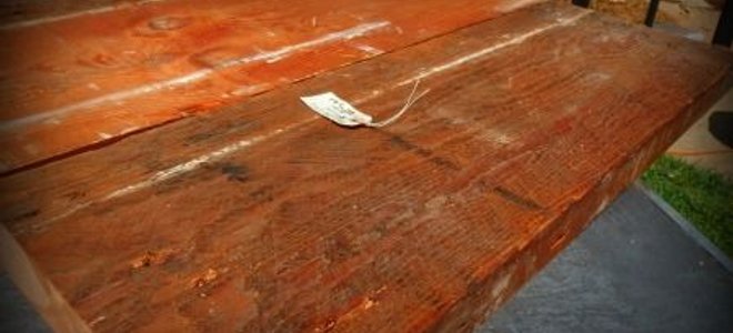

I love working with reclaimed wood. There’s nothing like the character of wood that’s weathered, aged, sun cured and flecked with old paint, tool marks and petrified moss. Or in this case, a couple of floor joists from a house torn down in Malibu.
I don’t claim to be an expert in anything, but I know that something like 20 percent of our landfills are taken up with construction lumber waste, and a good portion of that could find a new life. If you have legal access to a decaying old barn, you can source the old wood yourself. But even a scrounger like me needs help when I’m looking for something specific or in large quantities. I got these from E & K Vintage Wood in L.A.
They’ve got about a million board feet of reclaimed lumber of all different types.
When I got these boards, I asked their history, and they said they’d check and let me know. Next day I got this e-mail that says, “The two boards you have were from Frank Sinatra's house. That is where most of our Douglas Fir 2x12's are from.” And that’s it. No big deal. Frank Sinatra’s floor.

So, Frank’s floor joists and all this angle iron are about to be a table. First of all, these 2x12’s aren’t 2x12. They really are 2 inches thick, which a modern one wouldn’t be, but they’re only 11 inches wide. Unusual measurements are part of the problem-solving process of using old wood, and that gave me an idea.
I was going to build a 3-foot square top, but three 33-inch lengths would make a 33-inch square, and we wouldn’t have to rip any boards. And 33 inches is a good height for an end table, so we’ll make the whole thing a 33-inch cube.
I had enough lumber to get all three lengths out of one board, but the variation in wear makes for good character, so two lengths come from one board and one from the other.
