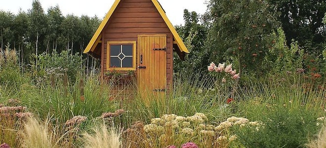

A wooden playhouse is a beloved, imaginative place for children to play, generation after generation. Building one for your kids or grandkids is a rewarding project that requires some basic woodworking skills and tools. It will take a few weekends to finish, but your kids will love it!

Step 6 - Cut Out Door And Window
people in the window of a black playhouse
Use tape measure and straight edge and mark the dimension of your door and window. Cut out with the circular saw. Keep the pieces of plywood to use for the door and window.
Step 7 - Finishing Touches
Attach hinges to the sides of the door and install back into the hole cut for it. Use a small latch for keeping it closed. Cut the window piece in half vertically and place two hinges on each half. Install these back into its original place. The window should open easily.
Paint the wooden playhouse with a color that will make your kids happy, seal it and it's ready for play.
