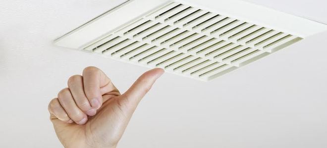

Is the exhaust fan in your bathroom working optimally? There's an easy way to test your fan for functionality. Take a single square of toilet paper and turn the fan on. Hold the toilet paper right up against the fan, and remove your hand. If the fan holds the paper on its own, then it's working well. If it doesn't, then you need to do some work to get your exhaust fan functioning the right way.
