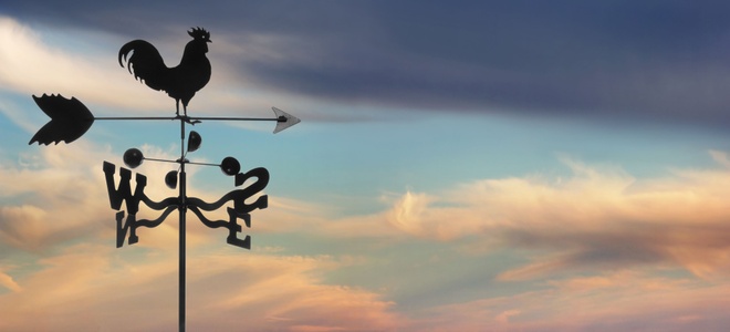

Step 1 - Assemble your Weather Vane
A traditional weathervane will have a brass rod approximately 28 inches long, a large and a small copper globe, a brass collar with set screws, a directional with set screws, a spinning ornament and a stainless steel inner rod and ball bearing. The ornament is affixed to the stainless steel rod, which sits inside of the brass rod, and is able to spin. The directional should not spin but point towards the north. Use your screwdriver to tighten the set screws and assemble the entire weather vane.
