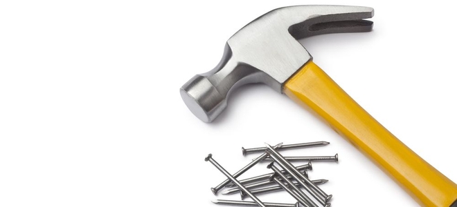

A Quick Primer on Nails
  • Nails are one of the most common type of metal fasteners used in construction today. They're available in different shapes (common nails, box nails, casing nails, brads, and finishing nails).
  • Nails are also available in numerous sizes, measured in a unit known as a Penny (abbreviated with by a lower case letter d). The higher the number, the longer the nail — so a 6-penny (6d) is 2 inches long while a 10-penny nail (10d) is 3 inches.
  • There are also a wide range of specialized nails. For example some have threading (like drywall or spiral nails) to help them hold more solidly. Others have special coatings of material like zinc or resins to prevent them rusting, and some can be a combination of both (like galvanized spiral nails used for outdoor work).
Nails are widely used because they're readily available and inexpensive, but there are some issues with nails.
  • Nails hold much better when they are driven across the grain of a piece of wood rather than along or with the grain, so nails driven into end grain can be pulled out relatively easily.
  • A nail is actually a form of a wedge. That means when it's driven into a piece of wood it can actually split the wood in two, particularly if it's driven too close to the edge or too many nails are driven along the same grain line.
  • Nails work best when used to hold pieces of wood together. If you need to fasten anything other than wood, nails really aren't your best choice. They don't work well with bricks or metal.
