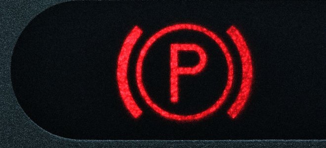

The parking notification on a dashboard.
