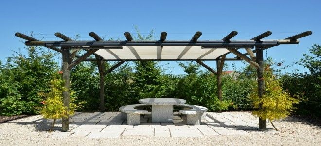

The simplistic design and square shape of a pergola makes it a great DIY project. If you have access to average wood working tools, have a deck that is raised high enough so that you can get beneath it, then this project may be one you wish to consider. The premise behind this project is to cut holes in the decking and place the upright beams through them. They can then be fastened to the joist beneath. Add some simple wooden edging, and you have a custom made pergola. Here, we discuss this project, materials needed, and construction tips.
Step 1 - Create Your Design
This design assumes you have a raised deck, and enough area to get the height needed. You should plan on the upright standards being 9 feet, as we will use 10 foot 4x4 cedar posts for construction. The pergola will be an 8 foot square with 4x4 cedar posts, doubled 2x8 beams, and use battens for mounting a sunshade. The plan is based on one of the many blueprints available on the internet.
