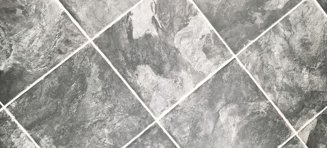

Vinyl flooring may be the most resilient kind of flooring, but that doesn't mean you shouldn’t give your vinyl floors a little TLC every now and then. Vinyl floors are extremely durable and can be renewed to an almost brand new state with just a little polish and some elbow grease.
