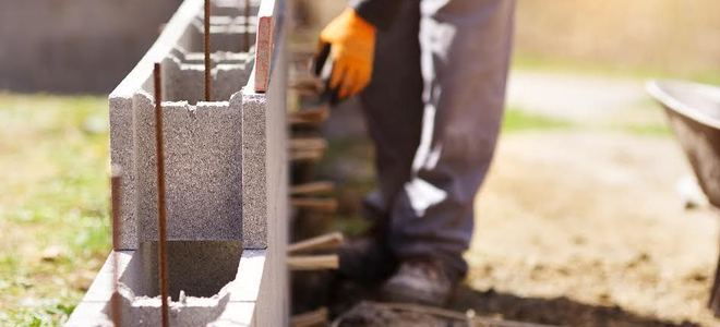

5. Buttering Techniques
The construction of a cinder block wall with a trowel and mortar.
It's easier to butter a set of blocks at the same time rather than individually. Simply place them on one end in a row and butter them together, using a downward motion with the trowel will help place the mortar in a uniform pattern. When you reach the inside edge of a block, press down on the trowel to keep the material from slipping off.
