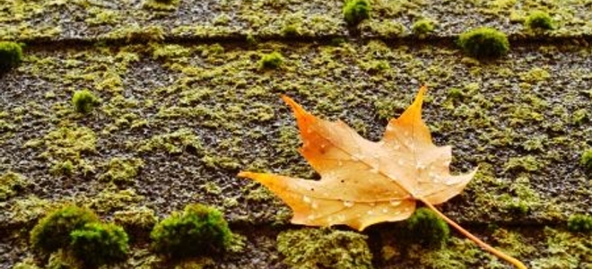

Moss
Moss is a non-vascular plant that obtains water through its leaves, unlike most plants that gather water through their root systems. Moss must have a constant moist environment to survive. In North America, it tends to grow on north facing roof planes that receive less direct sunlight and stay damp longer than south facing planes. Overhanging tree branches provide additional shade and drop debris on the roof that further holds in moisture and acts as a food source for moss.
Unlike algae, moss can be harmful to asphalt shingle performance. Moss growth can cause the leading edges of the shingles to lift or curl, which can increase the risk of shingle blow-off during wind events. Moss buildup can also act as a damming material and cause lateral water movement, resulting in moisture damage to the roof deck or leaks in the system.

Moss will loosen over time and may be removed with a leaf blower, but be careful not to break the seal of the shingle. This could affect its performance. Keep in mind, it may take more than one bleach treatment to kill all of the moss. Never use a pressure washer to clean an asphalt shingle roof as this could cause granule loss and very likely premature failure of the roof system. It is advisable to be aware that improperly cleaning your roof could result in voiding the manufacturer’s product warranty.
