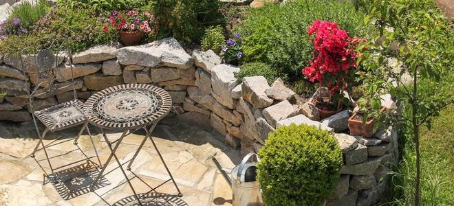

Patio walls are a great decorative and functional addition to your outdoor living space. You can use a patio wall to divide entertaining space or create more seating. An easy, do-it-yourself patio wall can be built with wall blocks available at any home improvement store.

Mark the edges of the row of blocks with a string and stakes. Remove the first course of blocks. Dig a wall foundation of about 4 to 6 inches. Remove all sod and soil from the marked area. Pour 3 inches of pea gravel into the foundation and use the compactor to tamp down the gravel, creating a steady surface for the blocks.

Starting in one corner, set the first several blocks for the first course. Use a level and add the first few blocks of the second course and level those blocks as well. Once you are certain the blocks are level, you can continue with the first and second course of blocks.

Continue laying blocks in courses until your wall reaches your desired height. Check periodically to be sure that the blocks remain level. If you anticipate that your wall may be used as seating, consider a second layer of wall blocks to make it double thickness.
While you can make a wall from poured concrete or flagstone, the wall block patio wall is the simplest patio wall, is functional as well, and looks elegant and finished. Adding a patio wall is a great idea for beautifying your outdoor living spaces.
