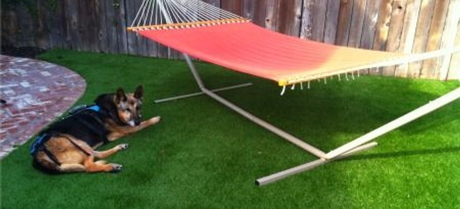

A big dog lounges comfortable on his new, artificial lawn.

We’re not talking about old-fashioned AstroTurf or that fuzzy green indoor-outdoor carpeting. Upon a visual inspection and even a touch test, it resembles real grass to a surprising degree.
The blades come in lengths from ½-inch, for a trim putting green, to just under 2 inches, for a thick lawn you want to take a nap on. It’s multicolored, so it doesn’t look strangely uniform, and each blade ends with a W cut across the top, so it doesn’t have the fake look a straight chop would give.
