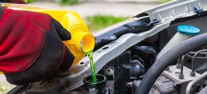

Step 2: Fill a Mixture of Coolant Fluid
Find the coolant recovery jug and then verify the coolant level. The coolant recovery jug is located at side of your car, right or left, depending on the model and manufacturer of your car. The top portion of the reservoir is often labeled "Engine Coolant Only" on it. Observe the line along the engine coolant reservoir’s side with the heading of "Full" or "Cold". There can also be the "Warm" level indicator, while the "Cold" indicator is the portion you will focus on.
Once the level falls under the minimum indicator at the "Cold" indicator line, you need to pour a 50/50 mixture of coolant fluid to make the level over the least indicator line. Short levels of engine coolant fluid might lead to car’s overheating, causing expensive and intense damage. The majority of coolants are available with a 50/50 mixture of coolant fluid, and will denote this on the packaging. When you decide to buy a concentrate, combine it with water in a 50/50 proportion.
Step 3: Examine the Engine Coolant Reservoir
Observe to see that your engine’s coolant reservoir is holding the added fluid. When it instantly or consistently falls under the "Cold Indicator,” you'll know there’s a leak, which must be repaired as soon as possible.
Step 4: Verify with the Radiator Filler Neck
You need to remove the radiator cap by pushing it down and then turning it counterclockwise. Check into the radiator’s filler neck. The coolant’s level should be positioned at the neck’s top portion. If needed, fill it up with a 50/50 mixture of coolant fluid. Put back the cap onto the radiator through turning it clockwise.
