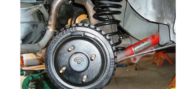

Rear brake repair is an inevitable part of vehicle ownership. The same forces of heat and friction that allow you to safely stop your vehicle will also eventually cause your brake pads to fail. As the pads are worn down, rough indicator ridges begin to emerge. These indicators grind sharply against the rotor when the brake is applied, creating an unpleasant squealing noise. Squeaky brakes indicate that it's time to replace the pads. If the pads aren't replaced quickly, the indicators can gouge the rotor and damage it as well. However, there are other possible reasons for the noise. If dirt and dust accumulate in the drums, it can cause the brakes to squeal. Before you go to the trouble of replacing your brake pads, run the vehicle through a car wash. Clean the wheels with high pressure hot water and solvent. See if the brakes continue to squeal after they have dried out. If they continue squealing, the automatic brake adjuster may be mis-calibrated. Take the vehicle to a brake shop or check it yourself. New brake pads will squeal for a few miles until the pads are broken in. In this case you can ignore the noise until it goes away. Besides worn pads, you may be suffering form distorted shoes and springs, a bent rear backing plate, or saturated linings. Any of these problems will require you to disassemble the rear brake and replace the damaged components.
Step 1 - Jack Vehicle
Loosen the rear wheel lug nuts while the vehicle is on the ground, and then raise the rear end with the jacks. Place the jack stand under the frame and lower the vehicle onto it, then remove the jacks. You can now remove the lugs nuts and tires from the rear wheels.
