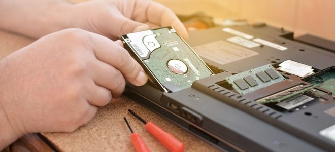

Remove Your Hard Drive
Warning: Before attempting this, make sure your computer is turned off and disconnected from any external power sources.
Open your computer's case—in desktops this can be as simple as tugging a lever, in laptops it will probably require disconnecting a series of tiny screws.
Your hard drive may be labeled as such. Most are rectangular, book-shaped objects, and tend to be stored near the front of the case.
open laptop with tools
Find the ribbon-like connector holding your drive in place, and gently work it out (some may be glued in place, so work gently and carefully to disconnect them). You may need a screwdriver again for this step, but most newer computers have a snap lock mechanism of some kind. Now find the power source of the drive and unplug it using whatever latching device it contains.
All computers are different, so just use caution while disconnecting their internal elements. Nothing should require excessive force to separate.
It's a good idea to put your drive directly into a static-proof bag when you get it out. This will reduce the danger of damage from moisture and ambient electricity.
