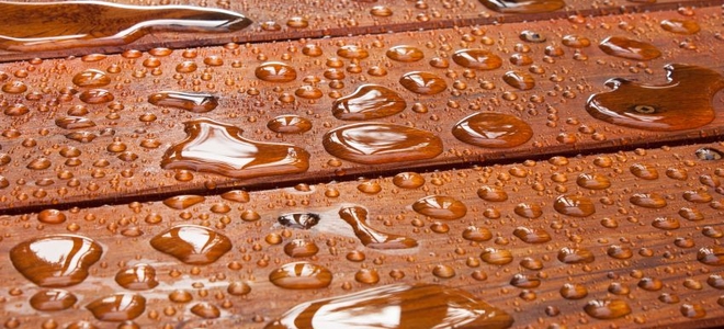

Staining a redwood deck is necessary if you want the wood to retain its beautiful hue. If redwood is allowed to weather without being stained, it will turn into an iron-grey color. Without staining, the wood could also crack.
With proper care, a redwood deck will last for many years.

For a redwood deck, a semi-transparent stain is an ideal sealant. You can find a color that closely resembles the natural color of the wood, or you can match the stain color to the trim or color of the house.
Semi-transparent stains soak into the wood, giving your redwood deck protection from rain and wear for two years or more. It also won't peel or flake as a solid stain will.
