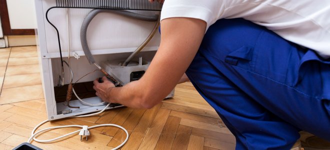

Freon removal is a cumbersome process, especially in the light of the discovery that Freon actually causes considerable harm to the environment. This is why you’ll be heavily penalized if you decide to cut off the Freon pipes of your refrigerator and let the Freon escape into the atmosphere. However, if you let someone else do the removal for you, the whole procedure is going to cost you, which is why you should just do it yourself.
Step 1 – Set up the Recovery System
There are really strict laws as to evacuating Freon from your refrigerator. As such, you cannot just cut open the tubes and allow the gas to flow into the atmosphere. You have to follow a strict set up when it comes to removing Freon. Using the diagram of your refrigerator, connect the red line to the sight glass via a yellow tube and the blue line to the recovery system. The yellow tube should be connected to the recovery cylinder and the recovery cylinder to the recovery system.
