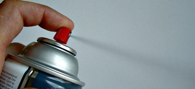

Step 3 - Paint the Ceiling Tiles
Ceiling paint comes in an aerosol can with the nozzle pointed upwards, making it easy to apply. Always shake the can vigorously for 3 to 5 minutes before using. Aerosol paints settle when stirred. The pigment must be agitated thoroughly in order to get the correct color and tint when spraying. Hold the can 8 to 12 inches from the damaged spot, and spray in light strokes. Allow the tile to dry for 30 minutes after each light coat. Compare how well the color matches before applying another coat of paint.
For plastic or metal ceiling tiles the process is nearly the same, except that a suitable ceiling paint may not be available. If possible, take an existing tile out of the ceiling, and have your local hardware or paint store mix a pint of matched color. Using a small, fine-tipped paintbrush, touch up the damaged area. Allow the first coat to dry before applying a second coat.
