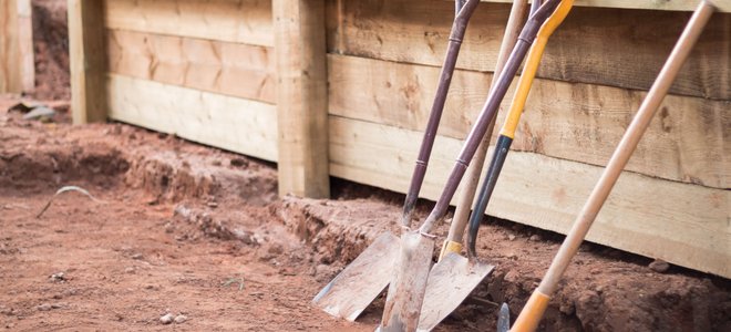

If the soil in your garden is of loose and soft quality, you may want to build a sheet pile style foundation. For this, you need to insert steel or wood planks 2/3 deep into the soil, with the top 1/3 remaining above the ground. This foundation design ensures good resistance of pressure in areas prone to frequent rains.
Tip 5: Wood Wall Foundation
Another retaining wall material that is immensely popular is wood. For such walls, make sure that the area where such a wall is to be erected is leveled. Make holes, so that the support beams to be inserted vertically fit in. The dimensions will vary according to the height of the wall itself. Ensure that at least 40 percent of the support beam is underground and that there is a space of at least 1 foot between the beams installed. The concrete and gravel must be mixed in equal proportion, to fill in the gaps in the foundation holes. Such a foundation design is very strong and helps the wood wall withstand immense pressures.
