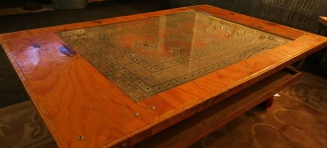

“Do you want this little throw rug?” my dad offered. I didn’t really have a place for it but, “Sure. I’ll take it.” What if I used the rug as the centerpiece for a coffee table? Given the amount of scrap I had lying around the only things I’d have to buy were casters and a piece of tempered glass.
Step 1 – Measure and Cut
Based on the size of the carpet (25 ¼ x 34 ¼-inches), I needed a table base and a frame. For the base, I cut a rectangle out of a trashed, old ping-pong table. I made it 7 ¼-inches longer and 3 ¼-inches wider than the carpet. (It’s possible you don’t have a scrap ping-pong table lying around, so use plywood.) Then I cut 4 pieces of plywood to cover the exposed ping-pong surface, and frame in the rug.
Since all the measurements are based on a rug that's not a standard size, there are a lot of fractions. It could have all been more even if starting with a standard element. You could easily adapt and build this around a Navajo blanket, a piece of tapestry or any other textile.

Turn the table right side up and lay the carpet in place. Set the frame pieces over the carpet, so they pinch it in place. Screw them down to the ping-pong surface. Face the perimeter of the table, and the shelf, with a strip of plywood or other material to fill in and hide the edge where the frame meets the table base.
Rolling Coffee Table Built From Scrap, Justin DiPego
Step 6 – Sand, Stain and Finish
This is a tabletop, so it will get some rough wear. Sand everything and since it’s made of various kinds of scrap, stain it so it all matches. When the stain’s dry, finish it with at least 2 coats of clear polyurethane.
Step 7 – Install the Glass
When the poly is dry, measure the exposed area of the carpet. Take these dimensions to a glass shop and order a piece of tempered glass to fit (24 ½ x 33 ½-inches). It will cost a bit more for tempered, but you don’t want it to shatter when you set your drink down. I was surprised to find this only set me back around $30.
With the glass in place, you’re done. Of course, since this is mostly made from scrap, it can be adapted according to your available materials and your taste.
