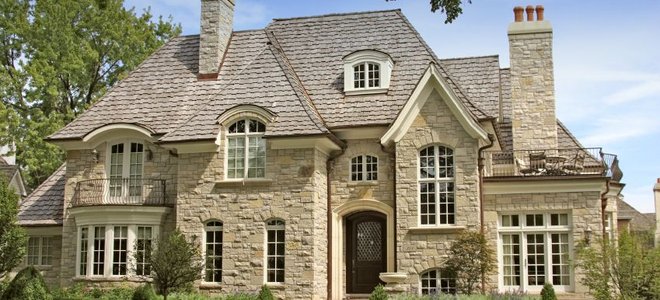

Cedar shingles make attractive roofs that are sturdy and long lasting. They’ve been in use for a few centuries and actually can help to insulate a home. It takes time to install a cedar shingle roof, but that actually makes repairs a great deal easier. As the shingles are applied individually it’s quite possible to replace a single cedar shingle in the event of a problem. The new shingle will weather to blend in with the others.
