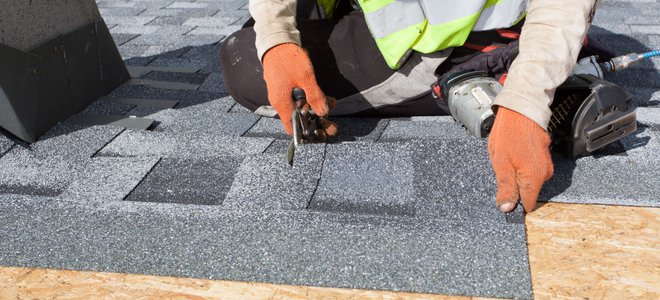

Roof repair and maintenance is inevitable for any homeowner. This can prove to be a costly project since contractors aren't cheap. Using these steps you will be able to save big on sheathing your roof!
It is assumed here that you will be applying plywood, particle board, or wafer-board sheathing. If you have chosen to use a rigid roofing (metal, wood shakes or shingles, tile, etc.), you can use 1 x 4 slats instead. With wood roofs, slats are a must to avoid rotting the wood shakes.
Plywood particle board or wafer-board roof sheathing is most commonly used, being low in cost and easy to apply. Choose an exterior C/D grade. Thickness will range from 3/8 to 3/4 inch depending upon local code. When ordering the sheathing, divide the total number of square feet of roof surface by 32 square feet (a 4' x 8' panel) and add an extra 15% for waste. An air compressor with a nail gun will come in handy for nailing large flat areas like this.

Step 1 - Check the Rafter Ends (Tails) Construction:
You want to be sure they form a straight line. If the walls are crooked, the rafter tails will also be crooked. Try to correct this problem. If you are unable to, pop a chalk line across the rafter tails and trim them with a saw before attaching the sheathing.
This is crucial because this building line will be a very noticeable when viewed from below.
Step 2 - Apply the Sheets
Begin applying the sheets from the bottom of the roof (the eaves) and work your way up to the ridge. The last course at the top may need to be rip cut if the roof is not in 4-foot increments.
It is important here that the sheathing at the eave line be exactly perpendicular to the rafters so that the sheets will meet at the centers of the rafters. It is even more important that it be perpendicular than that it is flush with the rafter tails. A tapered piece of sheathing can be cut to fill in at the eave if necessary.
Sheath one slope of the roof at a time, ripping the top course to the needed width at the ridge. When one slope is completely sheathed, pop a chalk line down any slope edge (as in a hip roof) that needs to be cut at an angle. You may prefer to cut these panels before you nail them in place
Step 2 - Nail it
Usually, code, which can vary locally, requires nails every six inches on the edge and 12 inches in the field. Pop a chalk line across the sheets to mark the centers of the rafters for a nailing guide.
Do not nail the edge rafters where the sheathing meets until the adjoining sheet is in place. This will enable you to move the rafter a bit if needed, so that the sheathing meets in the center of the rafter.
Step 3 - Stagger Joints
Stagger the joints of each course of sheathing. This can be done efficiently by cutting a panel in half and using these half sheets to start every other course. Special metal plywood clips will add stability to the splices where the sheets meet between rafters.
Carefully work your way up to the peak of the roof. Check for alignment and end support as you go. For safety, temporarily nail a 2 x 4 "toe board" horizontally across the lower panel of sheathing to brace yourself against as you add the second and subsequent courses of sheathing.
Step 4 - Cut Overhang
Set your circular saw to the correct depth and angle for cutting along the edge and saw off the excess overhang.
Repeat this process for each slope of the roof.
Sheathing your roof is as easy as 1,2 3, 4! As with any project, if you feel overwhelmed or unsafe, there's no shame in call in the pros.
