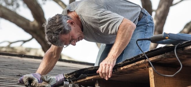

Step 1 - Examine your Roof
The first step is to determine the location of the leak so you can plan your approach. Sometimes it can be difficult to locate the exact spot because the damp circles on the ceiling inside your house may not be in the same location as the water coming in from above. Water can run down rafters or trusses and show up inside the house a good distance away from the actual source of the problem.
Try to get a good look at your roof from the ground or from a nearby perch with binoculars. If you see lifted roof shingles, that’s a good place to begin your investigation.
If nothing is apparent from far away, the next step is to climb up into the attic and look for water damage on the underside of the roof deck. This should give you the best idea as to the location where repair work will be necessary. Look for water running down rafters and follow the trickle back to the source. Often water seeps in around flashing on the roof, such as that next to vents or chimneys. Sometimes though, it simply skirts underneath loosened roofing material.
damaged roof shingles
Once you locate the damage on the roof, mark it with heavy bricks that will stay in place until you return with your supplies.
