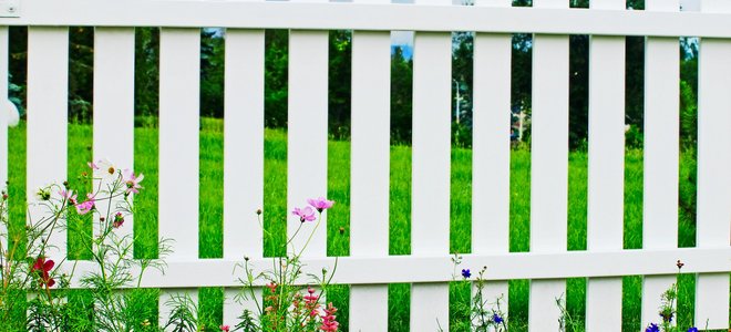

A white picket fence.
Fences serve all kinds of purposes. Some are practical—barbed wire or a corral fence, for example—while some are decorative—like that white picket fence around the cottage. Some are designed for a particular purpose, such as the five foot wooden fence around a yard designed to provide privacy. No matter what the purpose of a fence is, they all have fence posts.
