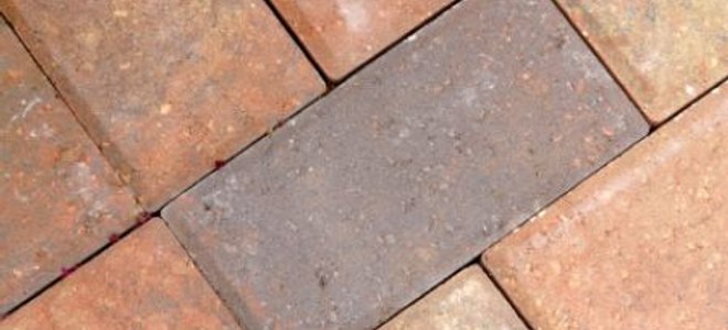

For any DIY project, knowing the amount of material needed is important. Working with pavers, these numbers are actually easy to estimate for some simple know-how.
Pavers
First, for the pavers themselves, you'll need to determine the square feet (length x width) of the area you want to pave. Using those numbers, estimate the number of pavers needed. For 4" x 8" pavers you will need 4.5 pavers per square foot. Using 3 5/8" x 7 5/8" pavers you will need 5.2 pavers per square foot. And finally, for 3 3/4" x 7 1/2" pavers you will use 5.1 pavers per square foot. Add five percent extra for chipped or broken pavers.
Example:
A 10’ by 20’ patio = 200 sq. ft. x 4.5 pavers/sq. ft. = 900 pavers
An additional 5% (900 x .05) = 45 pavers
Total needed so far = 945 pavers
Typically, you should also include an additional 1 1/2 bricks per linear foot of edge for cutting.
Example:
Linear footage = 10+20+20+10 = 60 linear feet
60 x 1.5 = 90 pavers
945 + 90 = 1035 total pavers needed for the job.
