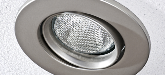

The best soffit lighting that you can install in your home is recessed or pot light. This is because it is a type of lighting you fix to the ceiling, projecting a downward light direction. The trim will be the light’s only visible area. In a home environment, you can install recessed soffit lighting in kitchens and bathrooms, or the library, den, or theatre room.

Place the light fixtures into the holes that you cut into the soffit. Press the black clips upwards with a flathead screwdriver until you hear it click down into the slot that there is in the soffit light fixture itself. Make sure that all the black clips are locked so that the soffit light fixture will be securely in place.
After you have finished the soffit lighting installation and you switch the light, you should see the light coming down from above. It will look somewhat like a large floodlight or a small spotlight. Such light fixtures have many names; they are usually called recessed lights or downlights, but in Canada, they call them pot lights and in the United States they are known as can lights or canister lights.
