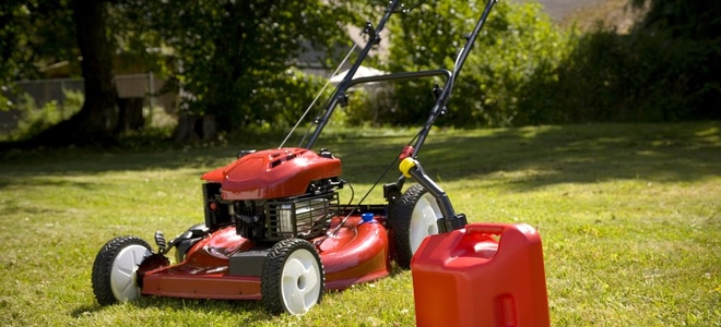

Is it time to put away your snow blower? Want to make sure the engine will start next fall when you need it? Small engines that are just put away once their season is over (snow blowers, lawn mowers), can be cranky and hard to start next season. Six months after you just left them in the garage or shed is not the time to think about what you could have done. Making sure that engine will start next season isn't hard and it'll probably take you less than an hour. Come next season I know you'll agree it was time well spent. Here’s all you have to do to make sure that the engine starts.

That's it. All that’s left to do is store your snow blower/lawn mower away from weather and animals for the season. Come next year, tighten the spark plug, fill the tank with fresh gasoline and start it up. Don't be alarmed if the oil you squirted into the cylinder head makes the exhaust smoky for a few minutes until it's burned up.
