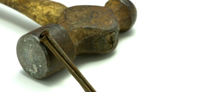

Well used ball peen hammer and two nails.
