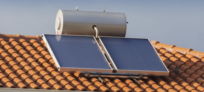

How to Select Solar Water Heaters
Through specially designed systems, energy from the sun can be used to heat water for your home. Depending on climate and water use, a properly designed, installed, and maintained solar water heater can meet from half to nearly all of a home's hot water demand.
Two features, a collector and a storage tank, characterize most solar water heaters. Beyond these common features, solar water heating systems can vary significantly in design. The various system designs can be classified as passive or active and as direct (also called open loop) or indirect (also called closed loop).
Passive systems operate without pumps and controls and can be more reliable, more durable, easier to maintain, longer lasting, and less expensive to operate than active systems. Active solar water heaters incorporate pumps and controls to move heat transfer fluids from the collectors to the storage tanks.
Both active and passive solar water heating systems often require "conventional" water heaters as backups, or the solar systems function as preheaters for the conventional units.
A direct solar water heating system circulates household water through collectors and is not appropriate in climates in which freezing temperatures occur. An indirect system should not experience problems with freezing because the fluid in the collectors is usually a form of antifreeze.
