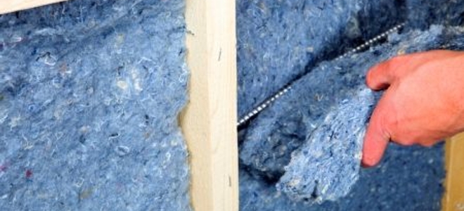

Step 3 - Install Insulation
Apply fiberglass or recycled denim insulation batting to the walls. Unlike for temperature insulation the batting can be packed in tightly, since the tighter the material the more sound will be stopped. When packing the material in. The insulating properties will be diminished by the tight packing, but your goal here is to block sound, not heat transfer.
An alternative to the above is to call in a professional insulation contractor and ask them to blow paper fiber or foam insulation into the open stud bays or through the holes at the top of the wall. This paper fiber or foam will adhere to the construction and provide both high insulation value and excellent sound deadening.
