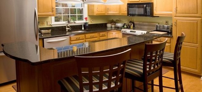

Step-by-Step Guide to Building a Kitchen Island
Kitchen with large island
