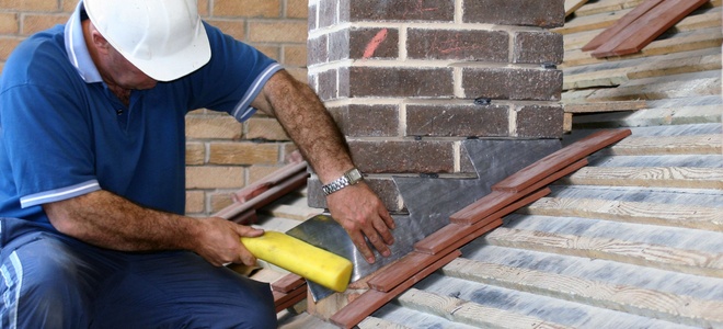

Man working on a roof near a chimney

Step 1 - Examination
Examine the chimney for cracks around the base, on the sides, and behind it.
Step 2 - Find the Flashing
Caulking around a chimney
Re-examine the sides of the chimney and look for six to eight inch long pieces of metal. This metal is called chimney flashing. When the chimney was built they blended the metal into one of the first row of bricks. In many climates this causes the mortar to expand and contract causing a chimney leak.
Step 3 - Investigate Cracks
Look for cracks between the metal and row of bricks on top of it.
Step 4 - Caulk it up
Place a medium sized amount of caulk all the way on the sides and back of the chimney except for the front.
Step 5 - Check One More Location
Also check where the roof shingles meet the metal flashing for another chimney leak that may exist.
