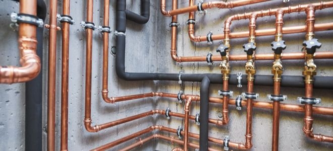

2. Rigid Copper Pipes
copper pipes
Another common plumbing pipe is that of rigid copper. These are typically used for water supply lines within houses. Since these types of pipes are not accompanied by any health risks, they’re popular for water supply.
Besides the health factor, there are other pros associated with this type of pipe. First, although the name itself suggests the fact that this is a rigid pipe, they do accommodate a certain amount of bending. Additionally, rigid copper pipes handle heat well and can withstand intense pressure. Unlike PEX pipes, they’re easily recyclable and retain monetary value even after they’re used.
Unlike PEX pipes, though, one of the cons of this pipe variety is that they’re not easy to work with for DIY plumbers. Although the material can be cut with a hacksaw or copper tube cutter, facilitating the connection usually requires a professional, as soldering copper pipe together is less than straightforward. Another con is that this type of pipe is on the expensive side. Finally, rigid copper pipes have a tendency to develop pinhole leaks and are prone to interior corrosion.
