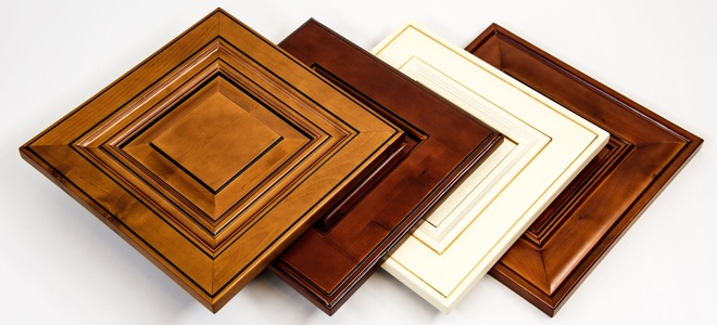

The Secret Life of Veneers
The Fine Art of Cabinet Facades, veneer
Maybe you can’t replace those cabinets, but you can make them look like new with veneers. Get yourself some thin sheets of plywood, 1/8-inch thick or less, and cut it to the exact size of your cabinet doors. If there is molding or some other decorative edging in place, cut the veneer to fit the space inside this edging.
First, sand both sides of the veneer. Choose the best side to refinish. With veneers, your cabinet options are practically limitless. Prime and paint them in any color you like to give your kitchen or bathroom area a fresh, bright look. The plywood can also be stained if desired, though you may wish to upgrade your wood if you plan on staining. Many people do not find plywood grain attractive, and stain does not cover the grain but enhances it.
Typically, veneers are applied with adhesive, but that's a permanent application. For a reversible look, trim the back of the veneer and the front of the cabinet with velcro tape. When you're ready for a new look, or need to go back to the original, peel off the veneer and clean the tape off the cabinets.
Molding can be applied in the same way as veneers. Get it in the appropriate size to attractively outline the cabinets. Cut it to length at 45-degree angles to make a frame all the way around doors and drawers.
