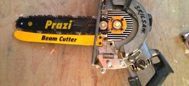

We were recently tasked with trying to figure out how to cleanly cut some 10-inch thick, reclaimed hand-hewn timbers for installation in a new home. The boss showed up that day with a nondescript cardboard box, and with much ceremony presented it to us as we sipped our morning coffee.
The first thing that occurred to me when he opened the box was, “That’s pretty cool. But where’s the rest of it?” By itself, it doesn’t appear to be much more than the business end of a small chainsaw.
But when mounted to the arbor of a 7 ¼-inch circular saw, a wicked wood-eating hybrid is born that would make even a lumberjack blush with enthusiasm.

prazi beam cutting saw

The effective cutting depth of a typical 7 ¼ inch circular saw is about 2 ½ inches. This means that in order to cut through dimensional lumber 4x4 and greater (think fence and deck posts), you will have to make at least two cuts: for a 4x4, one cut on each of two opposing sides, and for a 6x6, one cut on each of its four sides.
Even when you take careful measurements and square your cut line around your post, variations in the wood can result in an ugly or “off” cut. The beam cutter has an effective cutting depth of 12 inches, so you’ll only have to make one cut.
