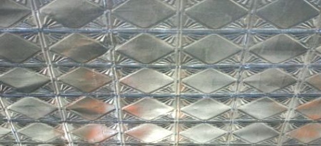

Old fashioned tin ceilings are making a comeback, and vintage tin tiles rescued from old construction are at a premium. You can achieve the same look for less money with new tiles and save even more by installing them yourself. Most reputable ceiling suppliers will offer detailed fitting instructions and most metal ceilings are fitted by their owners.
These instructions assume you have already painted your panels before installation begins. Painting them first is the easiest way to proceed - especially if you want the panels painted in fine detail.
Step 1 - Hang Plywood Panels
The easiest way to install pressed tin is to first affix plywood to the old ceiling or walls and then nail the tin to the ply. You can use timber battens, but plywood will make for a much easier job. For the best results, remove any existing cornices before attaching the sheets to the ceiling.
How you fit the ply to your ceiling depends on the kind of ceiling it is. In general, you measure the area of your ceiling and use enough plywood to cover that area, cutting it to fit the shape of your ceiling. Screw the panels through the plaster or sheetrock directly into the ceiling joists, with screws every 6 to 8 inches. If you are lucky enough to have timber ceilings, you can omit this step and nail straight onto the timber.

Before you attach the main ceiling paneling, lay out the panels on the floor. This allows you to familiarize yourself with them and get some useful practice for later. Ask yourself, when people walk into this room, from what direction do they see the ceiling? To keep the joins in the paneling out of sight, you'll have to lap the panels away from the main entrance.
Step 5 - Hang the Main Paneling
Tacking nails are quite long, but if you only nail them in partially they're pretty easy to remove with pliers. Use them while you're still trying to get everything into place. When you're done, replace them with smaller nails. The manufacturer's fitting instructions may have more information regarding the specific nails to use with their tiles.
Nail the main paneling from the center of the room out toward the edges, remembering to be consistent with panel lapping. If you are using a small pattern, continue to nail your panels right out to the cornices - trimming the outside panels until they fit tightly up against the crown cornices.
