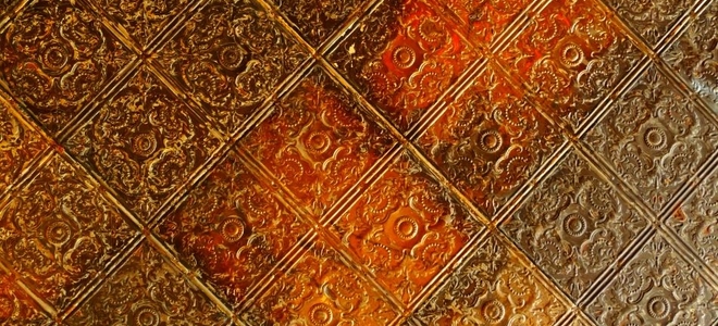

A close-up of some ornate, tin ceiling tiles.

With a little forethought, you can create a “tin” ceiling with serious “wow factor.” You'll love the amazed expression on your guests’ faces when they see your new ceiling for the first time. To get to that point, though, you need to spend a little time thinking about how the ceiling panels will fit your particular room.
For instance, if the pattern you have chosen measures 2′×2′, will you need to trim all the outside panels in order for them to fit the dimensions of your room? If so, you need to re-think your plans. You have two choices: go with a small, “all-over” style, which will look perfectly fine if trimmed to fit the room, or use a border panel around the outside of your room and have the larger designs in the center of the ceiling.
Most of the larger designs require a border or filler strip around the edge; otherwise, they don't look so elegant when installed. Border or filler panels usually have a small pattern on them, which complements the main panels in the center of the ceiling.
If you require a border around your main panels, it's worth consulting an expert to find out how wide the border should be. It is easy to upset the balance of your ceiling by having a border that is too wide or, conversely, too narrow.Do You Need Crown Cornice Molding?
