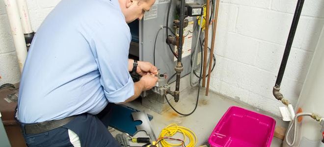

Man working on a furnace
While connecting the new wires, be careful to make the right connections. Make sure that the different wires that usually connect to the fan blower and the air conditioner are properly attached. Usually, connect the green wire to a terminal marked “G”. Sometimes, the terminal for the green wire is also green in color. The green wire is typically used to offer power for operating the furnace fan blower. Then there is the terminal marked “Y”, which is used to attach the yellow wire. This particular wire is used to connect to the air conditioning facility.
