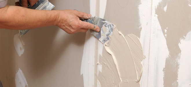

Joint compound is generally used after installing the drywall sheets to cover all the joints and seams, to fill in the corners even with the wall surfaces, and to cover up all of the screw holes and other irregularities of the drywalled surfaces. It is applied with drywall trowels and sanded even to the wall surface. A joint compound is a mud-like substance and sanding requires some special consideration to make sure it is smooth and flush.
Add Enough Compound for Smooth Finish
Before you can sand the joint compound it is important to note that good sanding begins with the compound itself. When applying the compound you want to make sure that there is enough applied for a level surface when it is sanded down. This means that the compound should be several inches on each side of the joint. Smooth it out as much as possible with the scraper to make sanding easier.
