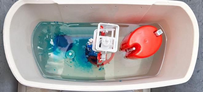

Step 4 - Add Dye
Add the dye tablet to the tank. Do not flush the toilet bowl for at least half an hour.
Step 5 - Wait and Check
After about 30 minutes, check the toilet bowl for traces of any color from the tablet.
If you see color, the toilet is leaking, and immediate action must be taken to amend one or more of the mechanisms inside. This is because a properly working toilet would store water in the tank until it is flushed with the handle. A proper toilet will not let the water run into the bowl unnecessarily.
Another Test
To know which part of the toilet bowl has resulted in the leaking, conduct another simple test. Use a pencil to draw a line on the back wall of the tank and on the inside of the tank at the waterline. Turn the water supply off and wait for 30 minutes. If the water level remains at the mark made by the pencil, the leak is occurring at the refill valve. The refill valve is located on the left side of the tank. If the water level falls below the mark made by the pencil, the leak is due to the flush valve. The flush valve is located at the center of the tank.
