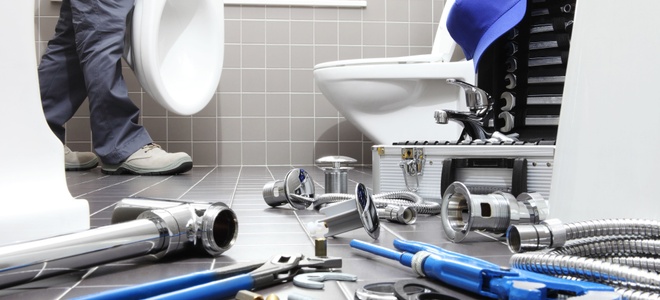

A toilet being worked on.
Basic toilet repairs are bound to be necessary from time to time. With some care and attention, you can perform basic toilet repairs rather than paying an expensive plumber.
