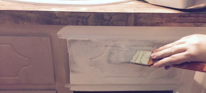

Prep: Now you're home and ready to get started, but before you paint the vanity you will need to do some prep work. If your vanity has drawers, remove them, and if it has doors and you're going to be changing the hinges out, remove those as well. Lay them to the side out of the way. Save the hardware for later in case you're going to paint them or for another project down the road. If you're going to keep the hardware the same, you can leave it on and either try to paint around it, tape it off, or paint over it with the enamel paint.
Next, tape off any part of the countertop and walls so that paint won't get on them. Also, tape your plastic drop cloth or garbage bag to the floor so that it will stay put as you move about the cabinet. As you tape, look for any areas that need filling in. Any holes or damage should be filled in lightly with spackle.
You're ready now to scuff it up a little so that your primer and paint will stick. Use your sandpaper and just lightly sand the vanity, including any spackle you had to use to fill in any damage or holes (once it's dry). Once you're done, take a damp sponge or rag and wipe it down getting all of the grit off. Dry it well or allow it to air dry and then get ready to prime.
Prime Time: The last part of prep is priming. Use your brushes, flat for larger open surfaces, and angled for sides and corners, and put the primer onto the vanity exterior. Remember to open the doors and get the inside of the frame that is going to show through when the doors are shut, and remember to prime any drawers or doors that you removed.
Cover the vanity with two coats of primer. Dry time is usually pretty quick (if you're not using oil), so it shouldn't take very long to do both coats. Make sure the first coat is fully dry though, not tacky, before you add the second coat.
*Note: When painting a bathroom vanity, using a separate primer is best and not a paint with primer included that claims to do it all in one step.
Step 3: Paint
It's now the time you've been waiting for, time to paint! But, again, make sure the primer is totally dry before you add your high gloss, enamel paint coat. You don't want it tacky at all -- you want it fully dry so that it's going to look good and stay on.
This is where your roller now comes in. If it looks like you're going to be able to finish this with one coat of your enamel paint, go ahead and use the mohair blend mini roller. It leaves a bit more smoother finish than a brush will when using a fast-drying enamel. If you think you may need to do it in two coats (usually this is the case), paint the first one on with the brushes and finish with the last coat using the roller. Use the angled-sash brush first to cut in the corners and sides and then roll.
